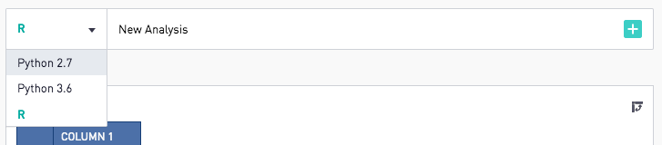

Once a SQL query has been successfully run for a new chart, select the desired language from the dropdown below the SQL editor and click the '+' icon to add a block of code. Periscope currently supports Python 2.7.15, Python 3.7, and R 3.5. Sites that had R and Python access before May 2019 will also include Python 2.7, Python 3.6, and R 3.4.

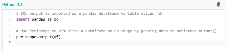

For Python, the pandas library has already been imported as pd, with the result set of the chart imported as a pandas dataframe variable called "df".

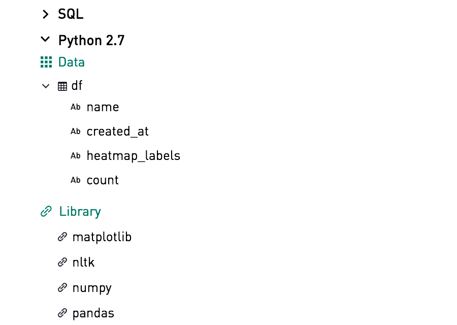

The data frame columns along with the data type are shown in the schema, The schema viewer also displays the list of libraries available for the chosen language, which link to the library's documentation.

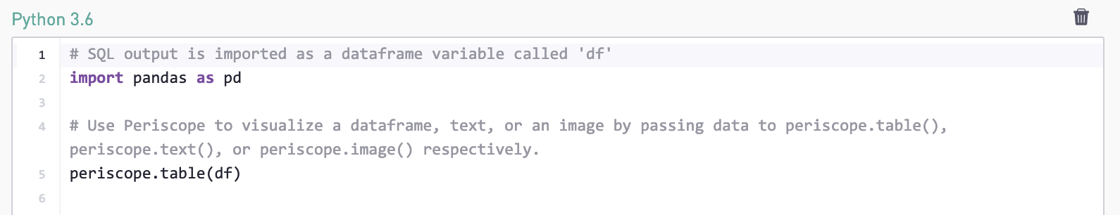

If the code outputs another dataframe (named df2) to be used by Periscope Data's charting functionality, the dataframe can be passed to periscope.table with the following syntax:
periscope.table(df2)
Similarly, for code that generates a plot (named plt), the plot can be passed to periscope.image like this, which would replace the common plt.show():
periscope.image(plt)
Lastly, for code that generates text (named txt), the text can be passed to periscope.text like this:
periscope.text(txt)

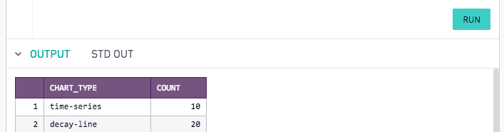

Data and text can also be printed to the Standard Out. Switching between the Periscope Output and the Standard Out can be done with the tabs below the code block Run button.

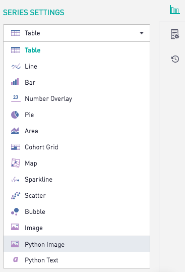

To use the Periscope Output or the Standard Out directly in a chart, select "Python Image" or "Python Text" respectively in the chart type drop down.
Note: The Periscope.output() function used previously is deprecated. It will continue to function as normal to avoid disrupting charts that use them, however the above specified functions should be used going forward.

Select R 3.5 from the dropdown below the SQL editor and click the '+' icon to add a block of code.

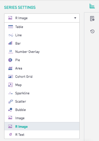

To use the Periscope Output or the Standard Out directly in a chart, select "R Image" or "R Text" respectively in the chart type drop down.

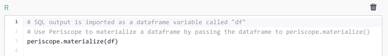

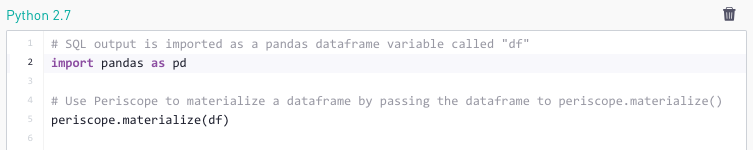

The code attached to a view should output another dataframe (df2) which will be saved as a table on the Periscope Cache or Warehouse to be used across the site in charts. This final dataframe can be passed to periscope.materialize() for materialization into the Periscope Cache with the following syntax:
periscope.materialize(df2)

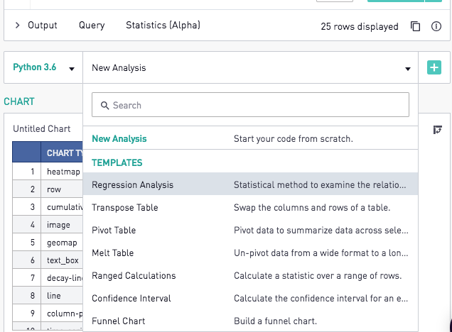

Code templates are available for common analyses based on popular posts from our Community. These Include the following templates:
  • Regression Analysis
  • Transpose Table
  • Pivot Table
  • Melt Table
  • Ranged Calculations
  • Confidence Interval
  • Funnel Chart
  • Statistical Significance

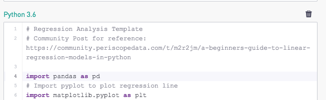

To select a code template, first select the language (Python 2.7.15, Python 3.7, or R 3.5). Then, click on New Analysis and select the desired template. The code for the template will be in the selected language.
Next, click the green plus to add the code for the selected template. In this case, code for regression analysis.
This will display the template code with a brief description and comments to aid in using the template.
To request a template, please post an example in our Community or reach out to Periscope Data support at support@periscopedata.com or over the in-app live chat.
