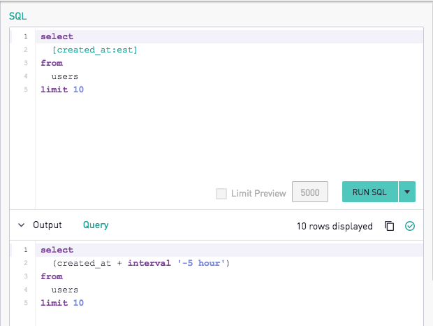

Convert a datetime to a given timezone by putting the time zone name in brackets, e.g.
select [created_at:pst] from users -- Convert created_at to Pacific Time
select [created_at:est] from users -- Convert created_at to Eastern Time
To verify Sisense's timezone math, click on the "Query" tab to display the expanded SQL.

US Daylight Savings Time
American time zones use the current UTC offset to convert all dates. To illustrate, during daylight savings time, the :pst operator applies a -7 hours difference onto UTC for all dates in the dataset (regardless if the exact timestamp being converted was during daylight savings time). When daylight savings time ends, the :pst converter will switch to applying a -8 hours difference onto the UTC time.
To perform the (more expensive) historically accurate conversion, prepend an "h" for "historical", e.g.:
select [created_at:hpst] from users
select [created_at:hmst] from users
select [created_at:hcst] from users
select [created_at:hest] from users
The historical timezone operators are accurate going back to 2009.
