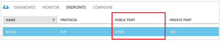

Microsoft Azure
For Azure, follow the following detailed steps to make sure that the SQL Server Database is accessible by the public Internet
  1. On the Azure Management Portal, click on VIRTUAL MACHINES.
  2. Select the virtual machine.
  3. Near the top of the page, select the ENDPOINTS page, and then at the bottom of the page, click ADD.
  4. On the Add an Endpoint to a Virtual Machine page, click Add a Stand-alone Endpoint, and then click the Next arrow to continue.
  5. On the Specify the details of the endpoint page, provide the name (MSSQL), public port (1433) and private port (1433).
  6. Click check mark to continue. The endpoint is created.
Now determine the public name of the host, called the DNS name.
  1. In the Azure Management Portal (or from the previous step), select VIRTUAL MACHINES.
  2. On the VIRTUAL MACHINE INSTANCES page, under the Quick Glance column, find and copy the DNS name for the virtual machine.
